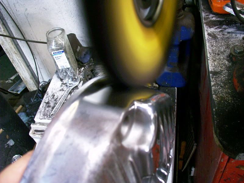

After your sanding, load the buffing wheel with compound. Turn the motor on and hold the compoud of choice to the wheel. Press it into it till it turns the color of the compound.
Now start polishing the part with fairly aggressive pressure. As you polish, move slowly and rotate the part so the compound on the wheel pulls at the sanding marks in different directions. Thats how it cuts the marks out and creates a smooth finish. You'll have to add compound as you go. It won't stay on the wheel forever, especially if your doing sharp edges like the fin's.
PLEASE BE CAREFUL NOT TO CATCH AN EDGE LIKE THIS!!!!! THIS IS HOW PARTS GET RIPPED FROM YOUR HANDS AND BECOME PROJECTILES!!! Let the rotation of the wheel go in the direction of the edge NOT against it!

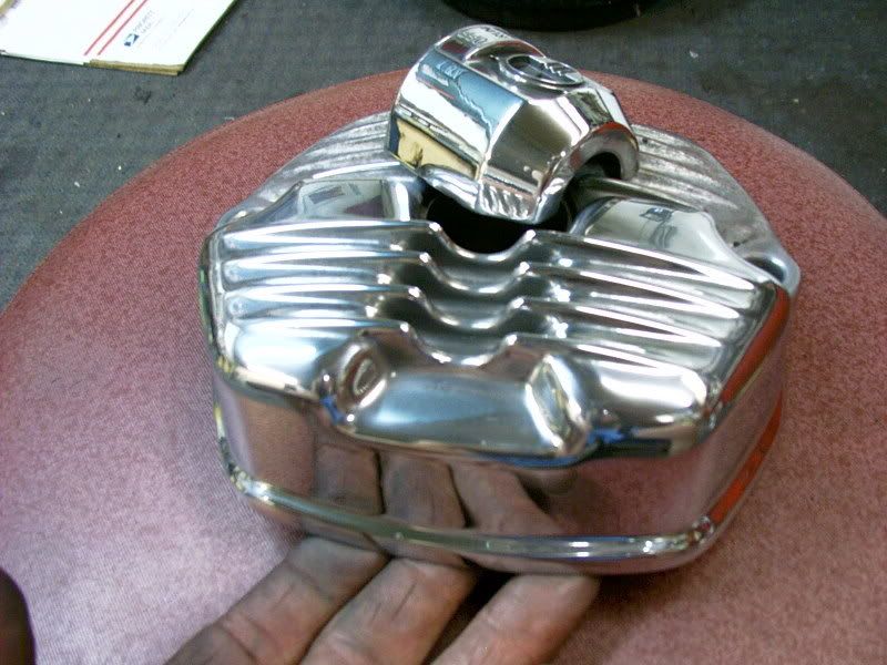

This is what you will end up with when your done!

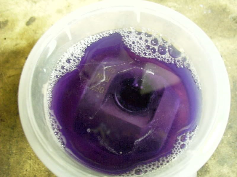

There will be NO sanding in this step unless you have dents or corrosion on them. Most of these part don't suffer from this though. At your local parts store, you will find a gallon jug of CASTROL SUPER CLEAN. This is the stuff that will stain and aluminum parts, even the anodized stuff. That's how I figured out that it melts an anodized surface. I cleaned my 78 CX 500 with it and it stained and clouded my rims. That's how I got started polishing my first set of rims.
Put your part in a container of this stuff, and sit back and watch the action. Leave it for about 1/2 to 3/4 of an hour and it will dissolve the anodized surface. Make sure your container has enough room for the foam to rise without spilling over. It will!
Hmmm, make sure you take all the electronic components out first, OK!
The white in the bottom is the anodizing being eaten away. COOL huh?
Take the part out after your selected time, some times it takes longer. If it does not buff off easy, put it back in for more soaking. Then rinse and dry it off and go straight to the polishing wheel. NO SANDING!
