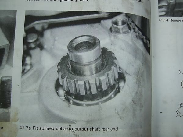

Note the correct positioning of the Main drive shaft small driven gear,
The teeth go INTO the drive shaft,not against the engine.This is very very important.
