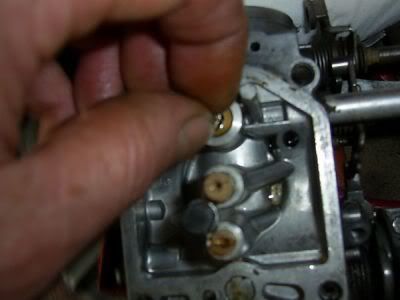

Another common problem with these carbs is that after taking them off and cleaning(See other Stickies for great information on correctly cleaning them) is that they overflow fuel.Once you know the float heights are correct this is usually caused by the Float Needle Valve not seating correctly because of curd/grit in the seat or on the Valve or the valve itself or the valve seat in the body damaged.If the Seat is too badly damaged the only fix is another set of carbs.
However in most cases you can service the FNV as in the picture below by putting some fine metal polish or Toothpase on it's tip and then inserting it into the hole and twisting it a few time gently(Like grinding in valves but much less harsh).Then totally clean the valve and the hole by blowing Carb/Brake cleaner on and through them so they are spotless.
This recommendation comes from my Haynes Workshop manual and I have used it several times with Success.
Note:If at any time you feel grit or dirt on your hands whilst working on the carbs go and wash you hands.You need to make sure 100% that no F.O.D(Foreign Object Damage) can get into any part of the carbs.To this end I always recommend fitting a small cheap in-line fuel filter so that any of the good work you do it not undone if something gets dis-lodged or through from the tank etc.
Also it's quite common after moving the carbs and on re-fit that there's a fuel overflow.Is this happens try tapping the float bowl of the offending side with a small hammer lightly as sometimes it takes a short while for the FNVs to bed in and also go for a ride and get really get some fuel through the system.If it continues you may have to try again until you get it right.

Note:something often overlooked when doing the Floats and Float needle valve is that the small Float Needle is actually,"Spring Loaded" and this can be corroded and seized.It should be drenched with Rust release/WD40 and operated so that the small plunger actually works.
If it does not move in and out freely it should be replaced same as if the tip is worn or scored.
